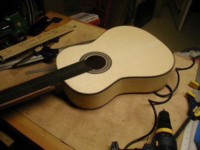

To all the flamenco builders -
How much extra relief do you add on the bass side of a flamenco fretboard? About the same as a classical? Or more, to account for the lower overall action?
Jim

It is looking good Jim. I add the same relief as a classical, just lower as the entire range is lower action. Note that I only add relief from around the 10th- 12th fret to the sound hole on the bass side of the fingerboard.
Closer to the head there is no additional relief although I have seen others that relieve more of the length of their bass side of the fingerboard but for me because I figure that the middle of the string length vibrates the most that there is the area where I start the relief.

Thanks, Shawn and Udi. I'll go back and check out R. E. Brune's article again.
I'm building 2 right now, both based on the GAL Reyes plan by Tom Blackshear. One is for me and one for a friend who is basically covering my costs. These are my first flamenco's, after 2 finished classicals. (The classicals are based on the GAL Rodriguez plan, also by Tom Blackshear. I owe Mr. Blackshear big time!)
The guitars are both Alaskan Yellow Cedar, which I got from Kevin Hall. The tops are both from Ed Dicks - this one is Englemann and the other is Sitka. I'd like to try Shane's Lutz on future ones. Necks are Cedrela. Ebony bindings, BRW bridge and headplate. I still need to detail the headstock, so no pictures of that yet. Finish will be french Polish. Aside from the different top material, the two guitars are basically identical.
I don't know any flamenco technique, so, as with my classicals, I'm going to have a tough time telling if they came out right!

The characteristic sound you will be looking for is alot of initial volume at the first attack but then not alot of sustain remaining as that is what would make a flamenco sound muddy. The more "dry" and explosive the initial attack is, the more that a flamenco player will like it.
Having said that, for your tops how did you treat the thickness differently between the Englemann and the Sitka? While each can vary, in general the Sitka top will be heavier but because of greater stiffness be able to be thinned more so the weight should come out very close to an Englemann top that is left thicker.
For the one you have pictured above that is bound, have you tapped in the area of the bridge and listened to the sound coming out the soundhole? You should be able to feel the air moving well and get a sense of its all around resonance.
It is not so much a certain pitch as it is how focused the sound is and whether the overtones you are hearing from the sound are balanced or mostly high partials. It is all subjective but can be an indicator as to whether the top is still too thick or whether it can stand more thinning.
The Reyes plan is a good one but for me my target as far as a flamenco builder goes is Barbero or for an earlier model Santos Hernandez but you cant go wrong with Reyes.

Thanks Shawn - I can't answer the question about difference in thinning the two tops too well. I'm going to start doing objective bending tests this summer, but didn't do it yet for these. They were both thin - way thinner than my two classicals so far. I would guess that the Englemann top came out less stiff as I thicknessed them about the same. I didn't really know what I was shooting for (one of the reasons for doing two side by side).
One of these days I'm going to start proselytizing for standardization of testing methods - everyone now seems to have numbers that are self consistent for their own work, but are difficult to communicate to others because the tests are done differently. That would kill us in the engineering world. (and you too, perhaps literally!)
The one pictured pumps a pretty good puff of air through the soundhole when thumped at the bridge location. The thump seems to be a pretty well-defined note, perhaps too low relative to the back's main tone.
Jim Kirby

Udi - The bridge is about 7mm high, with a saddle height on the bass side about 9.5mm. Blackshear says the neck should be set forward about 2mm, and put a little dome under the bridge. I used the solera for my Rodriguez plan, as the plans are not that much different except the Reyes is flatter across the tail and about an inch shorter as a result. I needed to taper the fretboard about 1mm over it's length.
Kevin Hall lives way up in Ontario somewhere, so no help there in not shipping from Canada.
